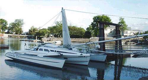

A friend of mine has a J28 or whatever it s called, and he takes the mast up and down on a regular basis using an inverted 'V' pole arrangement fixed just forward of the mast. Apparently it is common practice with this class of boat amongst the owners.
The feet of the V are fixed to the deck edge just forward of the mast, and a line goes up and over a block at the apex. The line is looped around the mast just below the spreaders, then the weight taken on it, whilst the mast is released at the foot. Mast is then gently lowered to the deck. Mast doesn't balance perfectly, but much lower loads involved than the regulation DF method of pivoting mast from the base, which I contemplate as quite scary!
Haven't wrapped my head around whether this would be possible with the DF920 mast, but would be good if it could:- I too am getting a bit fed up with the costs of crane & rigger to drop the mast.

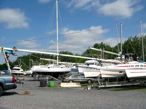

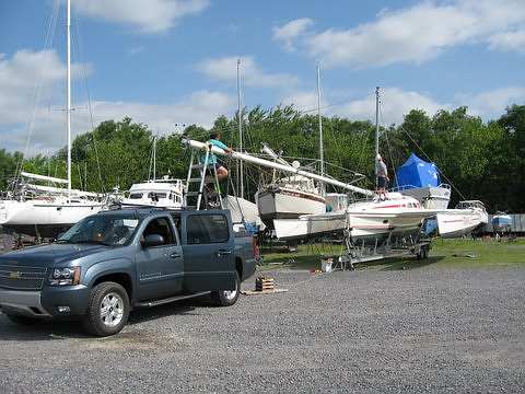

Yes those photos were taken when I used the lowering system provided by Quorning. There were some stressful moments but it worked out without problems.

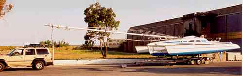

Dear sailors and friends,
I recommend to build a padded mast support which fits on the towing hitch after taking the trailer of.
The must support should be supported by some braces to a roof rack or similar (triangulation).
The mast support should be higher than the mast top height when the jockey wheel of the trailer is totally extended e.g. front the of the trailer is as high as possible.
Don't forget to add some padding to the mast support and some way of preventing the mast from slipping fore and aft but allowing the mast to be turned on its axis.
If you look at the enclosed photos you will see easily how it's done.
Now here is how it's done:
1) Unhitch the Trailer
2) Mount the front of the trailer to it's maximum height with the jockey wheel
3) Move the towing vehicle (forward) so that the tow hitch is just under the mast top
4) Mount the mast support on tow hitch and secure on vehicle (triangulation!).
5) Unleash the front of the mast and lower slowly the jockey wheel, the mast should rest on top of the mast support it in a way that it can be turned by 180 degree but secured that it can not slip!
6) Now lower the front of the trailer as much as possible (with the jockey wheel)
7) The mast will now rest on the mast support of the vehicle and will have lifted free from the boat.
The aft of the trailer must be secured against tipping down (large blocks of wood?).
9) Two people go on deck and lift the back of the mast. One person slooooooowly drives the vehicle forward while the two on deck carry the mast forward till the foot of the mast reaches the deck fixing for the mast.
YOU MUST STAY IN EASY COMMUNICATION CONTACT BETWEEN ALL 3!
10) Now turn the mast till the diamond spreaders show skywards.
Put the bolt in to the foot of the mast to secure the mast to the deck fitting.
YOU MUST REMOVE THIS BOLT AFTER RAISING THE MAST!
11) If the roller reefing is already attached to mast make sure it does not drop down.
If the mast support on the vehicle is high enough and the front of the trailer has been lowered enough the diamond spreader should/will not touch the boat! (see Photo)
Should the wires of the diamond spreaders touch the pulpit slightly but you still manage to get the securing bolt into the foot of the mast things are ok.
12) now fix the Windex, antenna etc and all the stays to the mast.
......AND FOLLOW THE PROCEDURES AS FOUND IN YOUR Dragonfly HANDBOOK!
I hope this is of some help and I wish you all the best with raising your mast this way.
