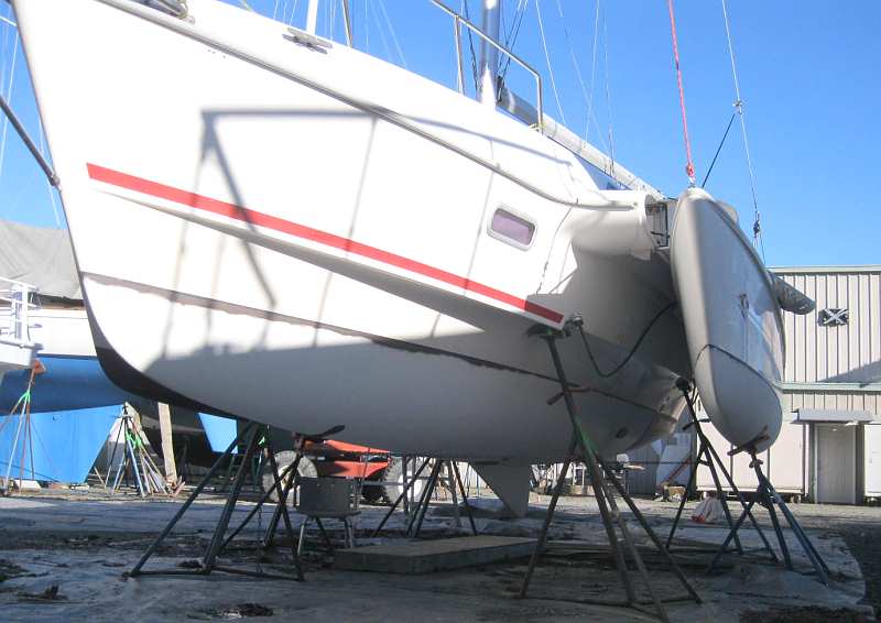

As an aside, check out the pic I've posted.
My boat, a DF 1000 is sitting on four jackstands with modified screw plates located at the cradle support positions .
The two stands below the amas aren't really doing anything, they were put there by the travel lift operator who said, "so I can sleep at night".
The marina is convinced four stands are ok and I believe them.
Steve
