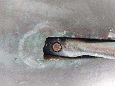

2. Lie under the boat and look at the forward end of the centreboard.
3. Locate the 12mm Allen key head bolt and remove with Allen key tool. We used a ratchet driver.

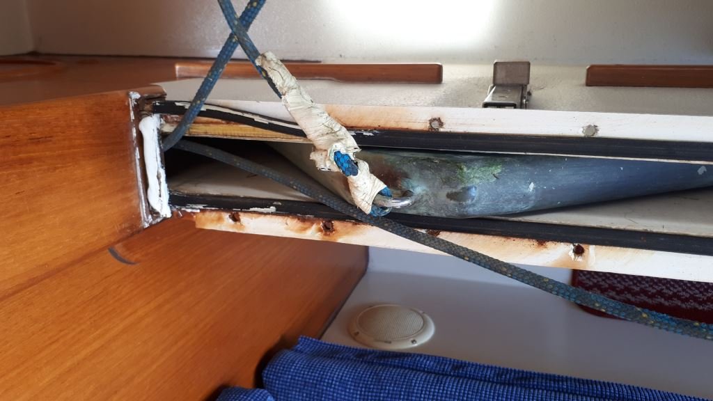

7. So.. we removed the table from the top of the centreboard case, this is quite simple but there are a lot of screws and a drill driver tool helps.
8. Now that the plate is disengaged from the pivot pin, it is possible to lift it using the control lines upwards into the cabin space, enough to access the knots where the lines attach.
9. Join the new lines to the tails of the old ones and pull them through. In our case we couldn't undo some stopper knots so we had to cut our old rope.
