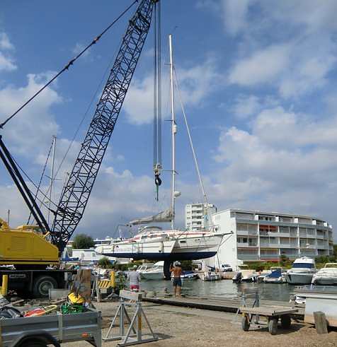

Thank you Larry,
I don't see the crane complily on your picture.
I think the crane must be a mobile one so that it can go between the backstays and the mast where the gravity center is.
The crane of our marina only rotate so the backstays are a problem.
We have to go in an other marina.
Eric
Eric

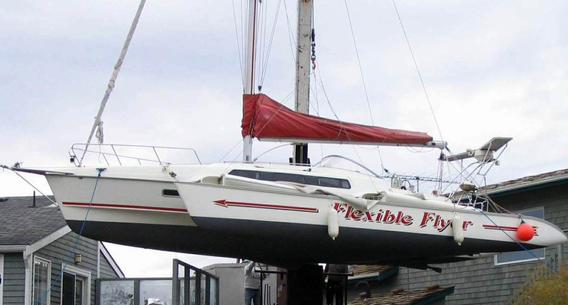

Lifting a DF1000 with a single point harness
The tip of the crane must be above the cap shrouds (backstays).
The lifting point is just forward of the windshield.
I have an old pic when we lifted my boat at the house and will send it to Bo.
Steve B.
Here is the photo showing clearly the lifting cable and the crane hook:
Steve B.

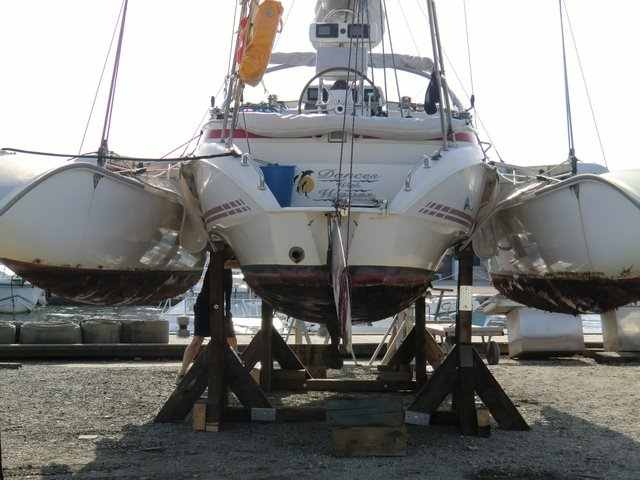

We put the boat ashore without pb with the harness.
It is very safty because of correct position with the center of gravity and no pb with speedo.
The crane must be high enough to be above the backstays when in lifting position.
For the craddle, we choose to build it in wood, it is more simple for me, my weld is very bad.
It has to be adapted next time with higher erternal oblic legs to support the entire weight of the boat.
An other post by Bo gives the length of the harness and is helpfull in DF1000 user topic "Lift a df1000 with lifting cables "
Pictures of the lifting:
![Image](http://www.dragonfly-trimarans.org/images1000/lift3_s.jpg)
