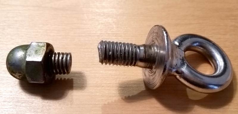

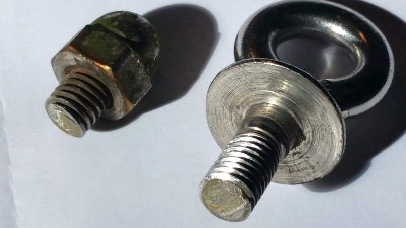

We have always had our 920 lifted using the lifting eyes and rated strops until this time when one of the lifting eyes BROKE! The boat was three quarters of the way out of the water when the shaft of the forward port lifting eye sheared off.
No we didn't see any warning signs. There was no rust bleeding evident and all appeared as normal. We checked they were tight and aligned correctly just before the lift.
We have now replaced all 4 eyes with some new larger ones. Originals were 10mm diameter and the new ones are 12mm diameter.
