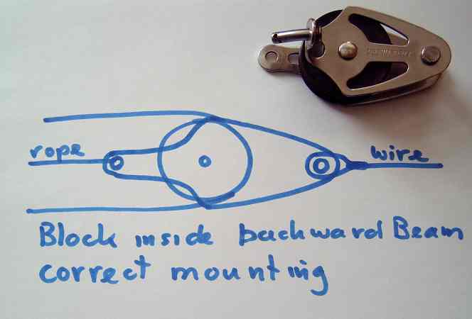

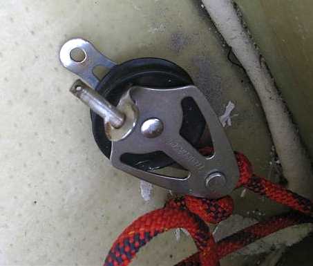

- Inside the backwards beam the block connecting the swingwing-line and the wire to the net is bended open (broke).
It was also mounted 180 degrees. It is not a symmetric block and it has a strong side and a weaker(?) side. This was mounted not correctly.
Remark: If you see this block the first time you migth not probably notice this. Im my case, I never had a look at it, it was already in place, done by the prevoius owner, who sailed with it.

As a owner of a DF800SW I am a bit worried about this analysis.
Knows anyone the correct mounting of the inner block in the backward beam? I am afraid, nobody does it. Can Quorning give us a detailed description of this important item as a extension of the boatmanual? If possible with fotos.

I don't quite understand the orientation of the block in the rear beam bit, and note that the back-up tube seemed to break where the pin goes through it at the rear beam attachment. Maybe asking a lot of aluminium to take those sort of loads where already weakened by a couple of holes?

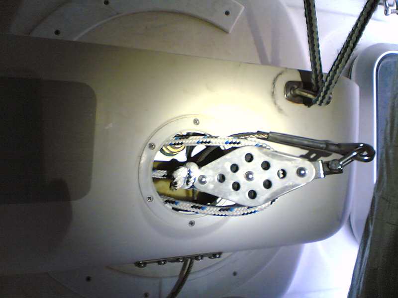

I have just looked at the blocks in my arms, I can see no difference in the sides of them ? More information please, I have a 2000 number 55 920. BUT I may have a clue to your problem, both my arm blocks are rigged differently!!!!!! and one block is being forced open !
This is difficult to describe, there are 2 pullies in the end of the arms, one is horzontal and one veretical, The end of the outhaul line which is fastened to the block in the arm was on one side in the lower part of the vertical block and on the other side in the top.
with the I belive only by looking that the end of the outhaul be made fast to the block and then go to the lower side of the vertical turning block, This seems to me to give a good run for the rope. the side on my boat that had this line going to the top of the vertical block has opened out the sides of the block???????? So am I right in that the line from the block in the arms should first go out via the lower side of the vertical block?

Ama internal blocks
The discussion of internal blocks for trampoline tension and unfolding the boat is an important one. I for one, would like to see pictures of what people have found. What has been discussed is disconcerting to say the least.

Folding block arrangement
I checked the folding system of my DF1000. The block is bigger, but otherwise the system should be similar to DF920 and DF800.buckle.roger wrote:Thank you bo and Jens for this prompt report , it is most encourageing and as was to be expected no signs of design problems.
but the correct rigging for this internal arm block is not described.
As in my last post, one arm block in my 920 is being forced open I think by the outhaul line to the becket going into the arm via the top of the vertical block in the arm, this twists the block , It would be nice fro the correct rigging to be known so owners can check for the correct fitting in all respects of this block
Attached you will find a technical drawing of the system rigging and forces. This explains why the block needs to be installed in right way.

Installation of block in backward beam DF920
To all who had quastion about the mounting of the block:
Enclosed you will see 1 photo of the block bended open after the accident
with my DF920.
The block is asymmetric and the rope was mounted at the wrong side.
(something I didnot know).
In the sketch I made you can see the correct way of mounting.
The wire is then connected to the strongest part and the rope with have more space to run through.
Of course a solution to avoid this problem is to use a symmetrical block of the right strength and enough space for the rope.
with my DF920.
broken block
curious!
it seems not to be the block itself wich is broken, only the ring is gone, and then the block opened?
- Posts: 440
Re: broken block
Interesting. Was there a ring there originally?jf.brodin wrote:curious!
I have seen other situations where a ring snagged on a rope and was pulled open, then it could come out by itself if turned from vibration or handling.
For that reason I prefer cotter pins to rings. It's unlikely a properly bent cotter pin would straighten enough to come out on its own, but for a ring to come out it just has to be deformed enough to create a gap in the overlapped portions.
If you have retaining rings holding the clevis pins on your nets (including the aft outboard corner block) they should be replaced by cotter pins, in my opinion. This also applies to the lower connection of the top shrouds (stays) which have sheets running past.
Re: broken block
When you analyze the loads on the block it becomes clear that when properly oriented, the load on the wire end equals the total load of the three "rope" ends. One entering the block, one exiting the other side of the block, and the terminated end on the (now bent) pin. The block was designed to provide load bearing with minimum weight when properly installed.jf.brodin wrote:curious!
The block carrier is obviously meant to take the full load on the right side end, while distributing the load to the left side between the becket (failed pin) and both sides of the block.
Taken in that light, I suspect that the block is not at fault, nor did the ring fail. In fact, with the becket pin bent like it was, the retainer ring may very well have been cut or otherwise destroyed due to the outward forces of the carrier sides as the pin was bent. The remains of it may still be inside the aka.
The block was simply overloaded by improper installation by (who?)
IMHO, someone took a 50/50 guess at orientation and got it backwards.
