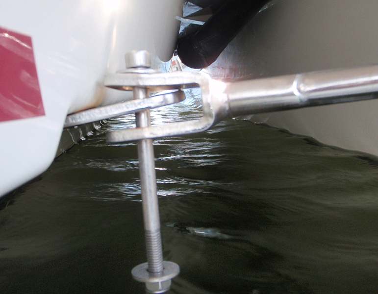

Made a repair at sea. Used one spare bolt from the engine mount.

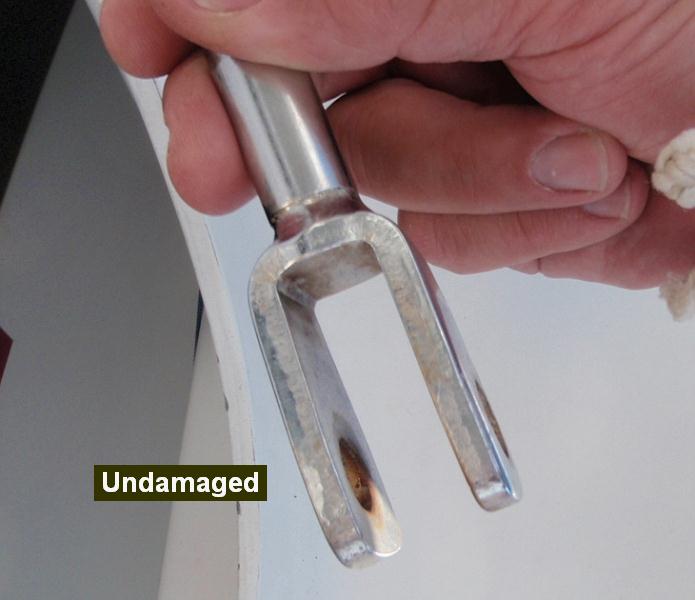

Look at the pictures. Left is repair at sea, and right is the original on starbord. Is the mouth of the waterstay bent so much on the left one that it have to be replaced?
